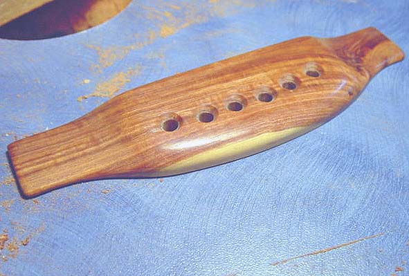

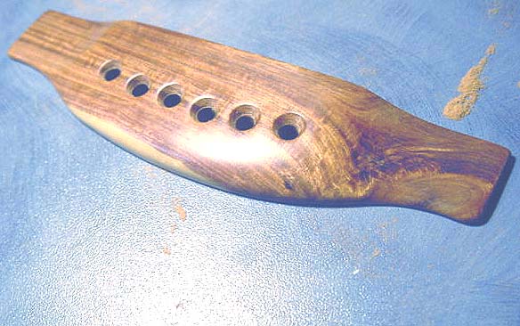

I had originally polished this out when it weighed 34 grams. But there was a chip out, as can be seen in the first image, on one of the bridge pin holes. This foepah was caused by my own carelessness and I just could not stand to look at it so I reshaped and contoured the belly across the pin holes removing the divot.
This knocked off another 2 grams which is fine by me as I did intend to brace light anyhow and by my calculations, this weight should be fine on the broader expanse of an SJ style guitar.
Anyhow, here is the 34gram version complete with tear out.
And here is the 32gram version.

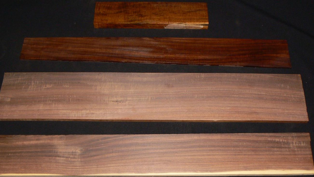

To that end, here is another image of some Mulga in standard, wide and radiused forms. There is a bridge blank of some Curly/fiddleback Minnerichi in the back ground. At least one US luthier found that the Mulga was very similar to Texas Ebony, if that is a good comparison for those who have used it.

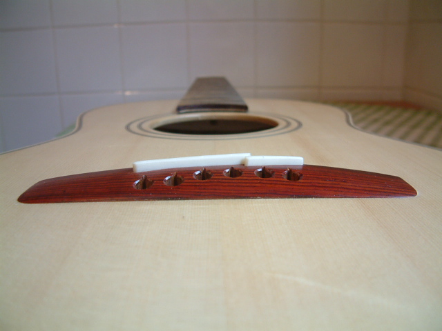

I love the saddleless bridge design, but just wondering where the strings are going to break over

Dave, your bridge looks to be a masterpiece of function and form, I realy like the look of the split saddle and may adopt that myself some time.

Rod, strings???,,,,strings,,,,,Oh crap STRINGS!
I have one of those Stewmac thingy-ma-jigs to cut the slot when glued onto the guitar. The complete area of the bridge where it will be slotted has been left at 5/16". Oh, and the wood that came with your Aussie kit had Mulga and Minnerichi as I recall, have not seen any Milka and Gingrich in these parts

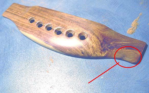

That's a very pleasing and graceful design Kim. However, I have a concern with an area of the bridge. In the picture below I've circled what look to me like a knot. If this is so it may present problems in the future as wood around knots contracts and or expanse differently during humidity changes and a knot may eventually loosen and fall out. If it's not a knot then disregard my comment and the bridge should be fine.
